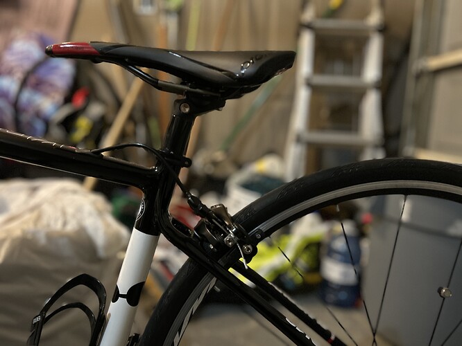

Hello everyone,
I just got Garmin Varia Rtl515.

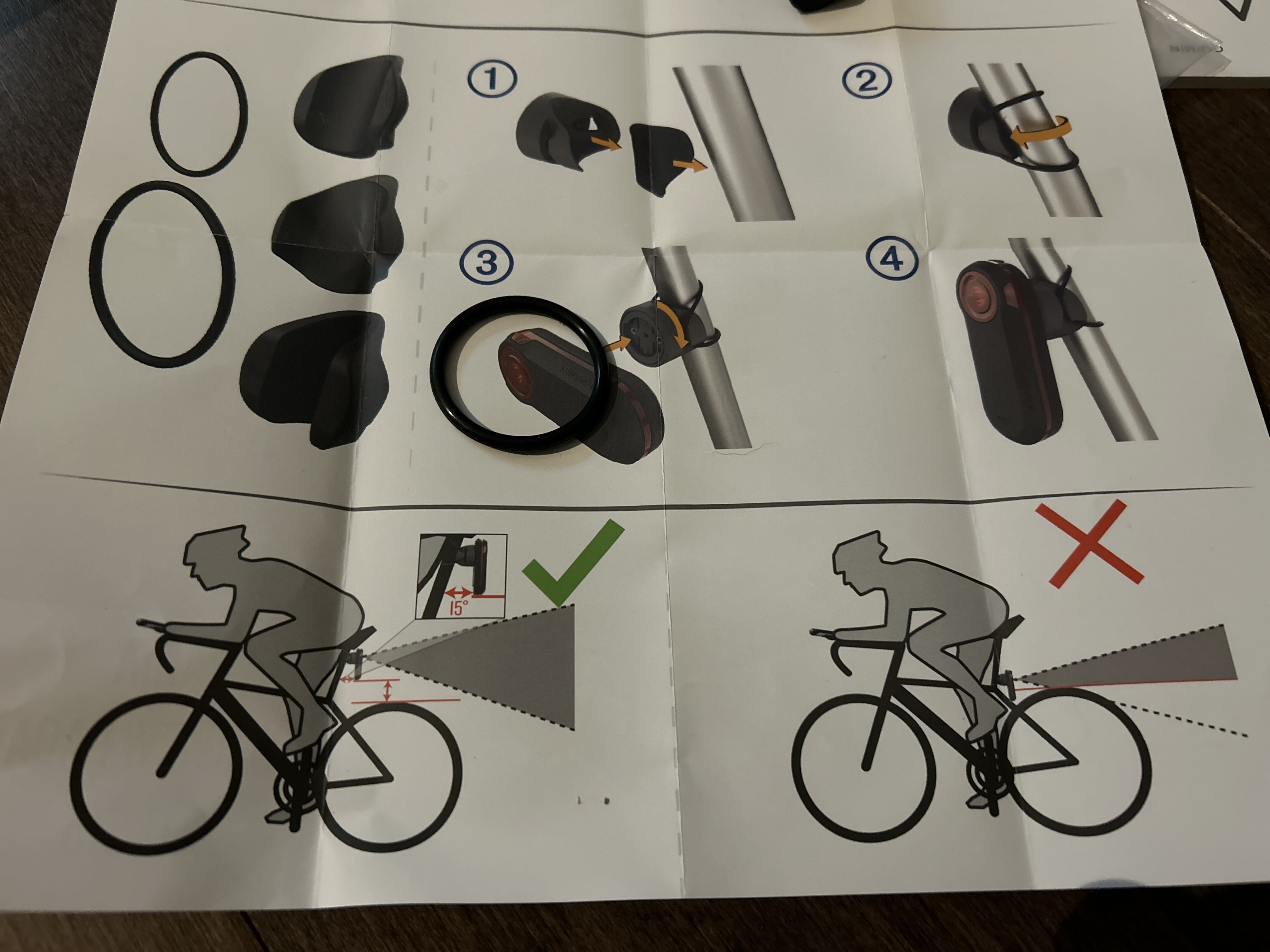

I looked at the instruction picture and found out a big problem.
I am very short, so is my seat post.
Is there anyway I can still mount the light to my bike?
If anyone have an idea please let me know.

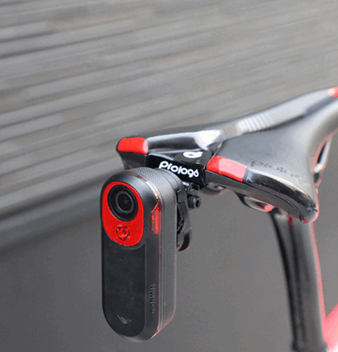

You could get one of those Varia mounts that are secured to your saddle rails instead. There should be more room for clearance

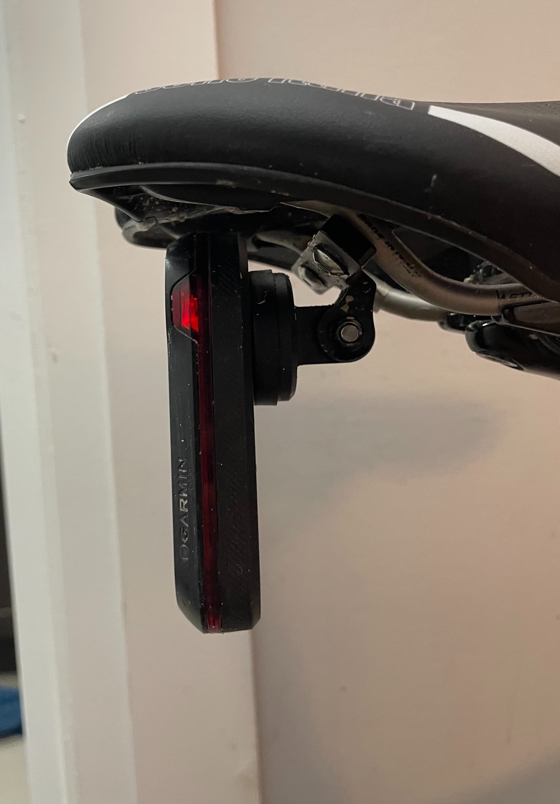

This is my setup:
on Garmin’s site: Seat Rail Mount Kit | Garmin

I am worried that I still wouldn’t have enough angle as shown in the instruction.

If you need a temporary solution, you might be able to mount it on your helmet. (I had the same problem when I rented a fat bike and had not much seat post)
Check if there are two holes under your seat. These are specific to the seat manufacturer, but could be used to install a quater-turn adapter.

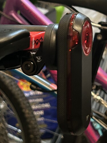

Thank you for sharing your setting and experience about an installation of Garmin Varia.
I decided to try this setting. Hope it works.
