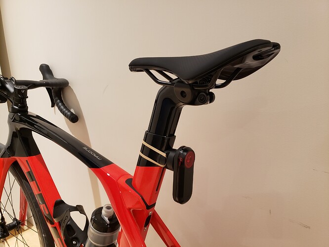

I have tried using the stock adapter and pads that came with the radar. The two elastic bands it came with are too short and I had to resort to household elastic bands (not a road ready version, but good enought to check the fit and the looks).
One of the pads fits the rear side of the seat post just fine. At the same time it is far from ideal slick and solid setup. And I am pretty sure that over time it would rub against the paint enough to leave a mark/scratch.
