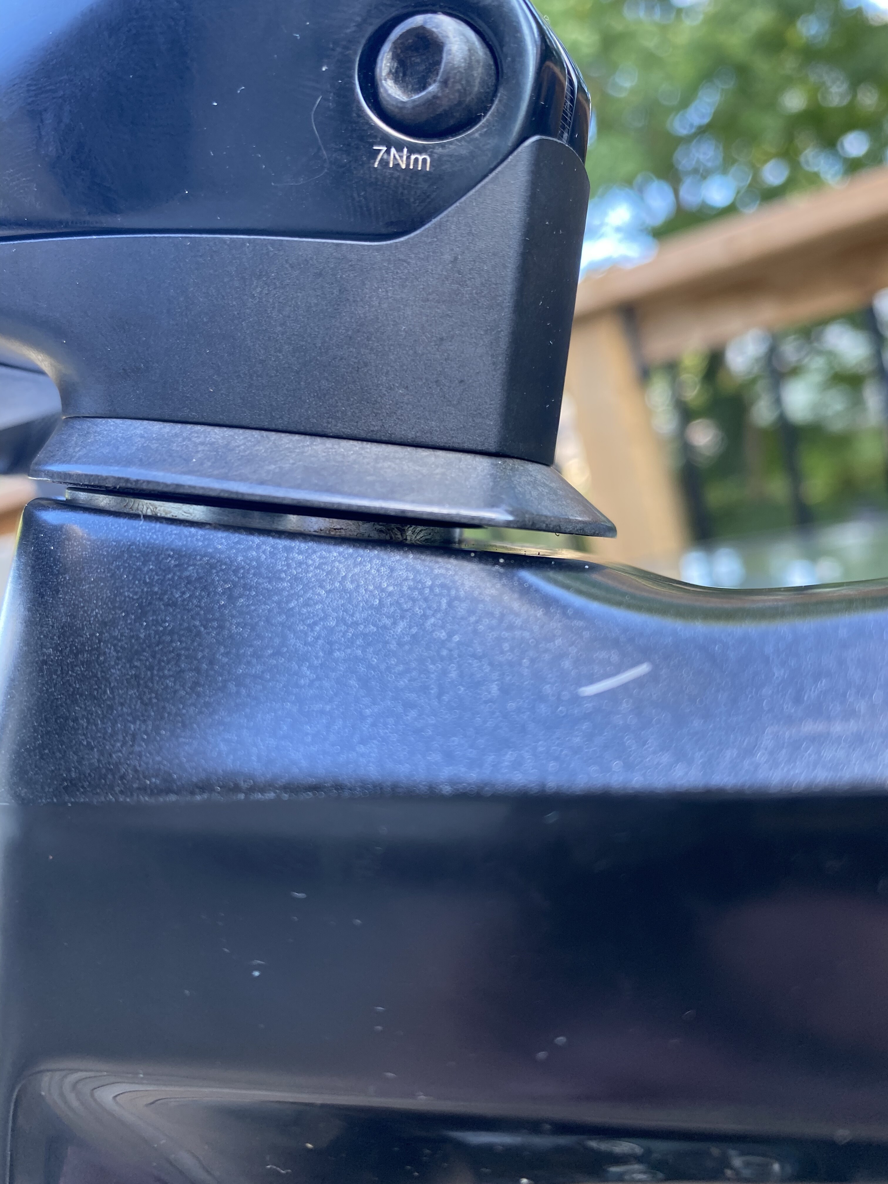

I took my BMC in last week for a headset job, both lower and upper bearings needed serviced. They called me early in the week and let me know they’re having a hard time sourcing bearings, but they have some that seem to be close. I thought he explained they had a shorter stack height which I took as being thinner. Today when I picked it up I could see a gap between the bearings and top cap. The mechanic that did the job wasn’t there, but they insisted that mechanically it was fine. I attested that moisture and sweat at the very least could get in there. I was not happy. I still reluctantly paid my full service bill and took the bike. What do you guys think? Is it safe?
Hmmm. I sent the pic to another mechanic and he wasn’t so sure?! Honestly these manufacturers design their products to be used and serviced one way. I wonder what BMC would think?
It looks like there is one of two things that could be wrong with the bearing. The first is the bearing could just be taller than the original one. If they were able to find a bearing with the correct OD, ID and seat angle but not the same thickness it will just protrude from the frame like this. You still have the same amount of contact within the frame its just sticking out causing that gap. you are right though, water is now able to get straight into the bearing and will not only get dirty quickly but will eventually cause it to fail sooner just from contaminants getting. So in my opinion safe but ugly and bad for bearing life
The other possibility is they the bearing has the right thickness but the wrong seat angle causing it to not fully sit in its proper place. This could cause damage because instead of the bearing sitting flat, a corner of it would be pressing into the frame (or headset cup) and could cause damage from riding. Unless you have the old bearing and can confirm which situation it is I’d hold off on riding. If you still have the old bearing it should say the sizes on the outer race. If that’s worn off they are easy enough to measure and order yourself.

I believe it is the first issue Chris, as when we were having a hard time finding one he suggested one with a difference thickness, I took that as going the other way, thinner some how. That is the angle they were going with as well when I picked it up. I mean it’s fully possible it’s option two as well.

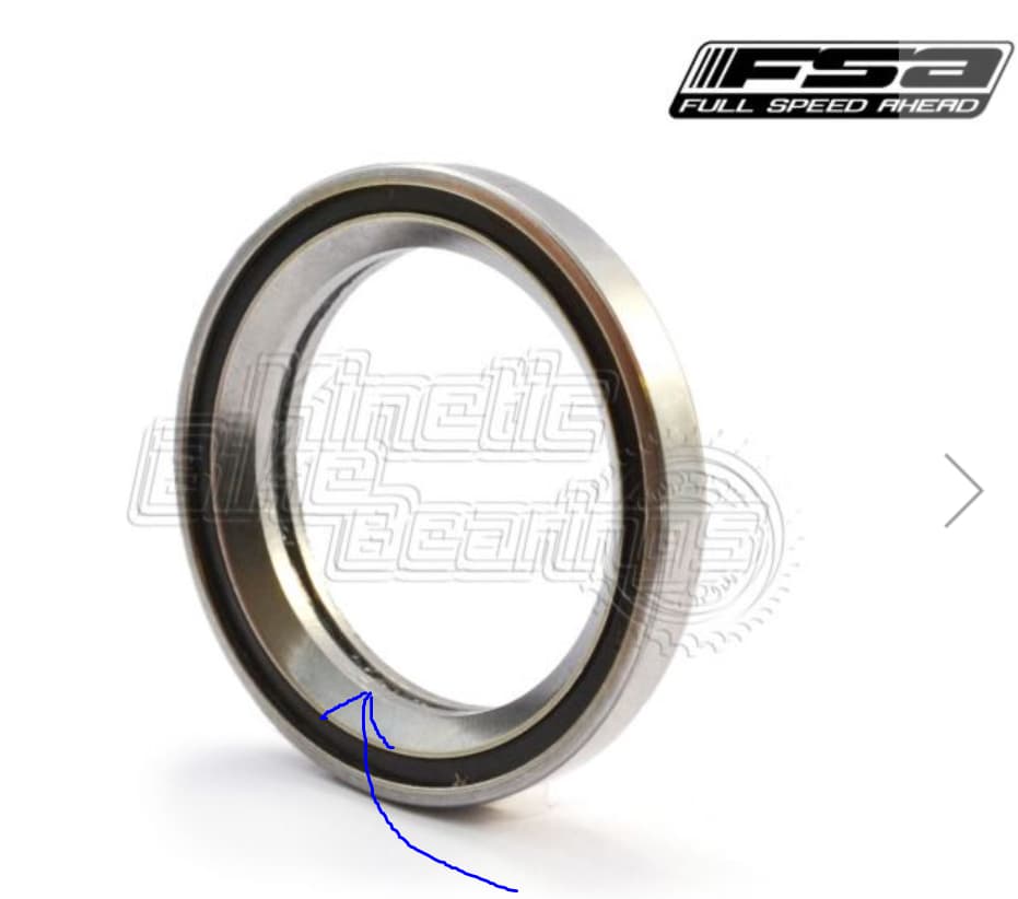

That is when the preverbal well depended. The bearings I ordered, the ones I swore were correct were not. To be clear the bottom was correct, its quite common (1.5) 52x40x7 36x45. But the top bearing was shorter than the old bearing we pulled out (H). Scrambling, I took apart the old top bearing, lightly sanded down the cups to remove some rust, made sure all the bearings were in tact in the nylon sleeve and added new grease. This is when I finally noticed, the top bearing had a what I understood as a gap, a lip in it. I wasn’t sure if the lip was supposed to be there or if the old bearing was just damaged.
So back to the bike store, I brought the new ones I ordered, and the OEM ones I tried to restore. The bottom installed fine as expected but the top did not. I mentioned the strange ‘gap’ lip to the mechanic and he wasn’t too sure. He tried the new top bearing I ordered but it still didn’t fit. He called me up and we had two options now, we can keep looking for the correct top, or we could re-install the old one refurbished up. He realized that lip, that movement I found in the old top is supposed to be there. It’s described as a ‘campy’ bearing with lip when you find them online. It fits into the steerer and that gap compresses I suppose? It creates that perfect flat top while also providing enough compression? I am still muddy.
Super long story short, we re-installed the old ones until the correct ones can be found. I finally heard back from BMC this weekend and they confirmed the correct bearing for this frame.
