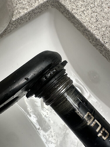

In case anyone thought I was exaggerating about the horrible noises my bike was making at the end of the race here are some photos of my bottom bracket and spindle:
The non drive side of BB was totally destroyed–the bearing housing was fused to and came out with the crank spindle. The spindle is deeply scored. I probably should have stopped riding when the noise got bad but I guess I’m too stubborn! Not only the noise but think of all those lost watts–I could’ve been a contender
I had the BB replaced after the original failed after the P2A last year. Now I bought a bearing press to replace it myself as it seems to be a recurring issue.
My question is why do you think this keeps happening? It seems out of the ordinary that a BB fails so spectacularly even in the mud bath of the P2A. Has anyone had similar issues? I generally keep my bike clean and well maintained so I don’t think its from neglect.
I have installed a new BB and it looks like I need a new crankset as well–this years P2A is continues to get more expensive!

I just replaced a BB on one of our P2A bikes last evening. My sons both have identical Canyon CX bikes and they raced the same distance at the same time. On one of them the BB was completely fine. On the other one it was toast and missing half of the bearings.
I think it mostly depends on how well the seal is able to keep the dirt out. If sand gets into the bearings they are not going to last.
Thankfully all of our CX and road bikes use the same Shimano BB. I just order a bunch of Shimano Ultegra bottom brackets from Merlin Cycles for ~$25 each and replace them myself whenever they aren’t spinning smoothly. Actually I just made a mental note to put in another order. doh.
To keep them running longer my tip is to cover everything with marine grease in an attempt to keep the water out. It doesn’t solve the problem but I think it helps.
Some bikes are just worse whether it be frame design or manufacturing tolerances. I had an old CX bike 15,000km and the bearings still felt like new of pretty much exclusively riding it in dirt and and the winter. I have others where it seems to be an annual repair with low km.
I think I’d rather go cheapish and replace often if needed. On that topic a member recently wrote their frame off from seized bearings spinning and wearing the BB shell on a pressfit frame.
The other tip that I would add is that if you can clean out the bearings after the mud race they can sometimes be salvaged without having to remove from the frame. Just don’t ride on them very long when there is sand in the bearings. That can work IF there is a way to remove the seals from the bearings with damaging any plastic caps.
