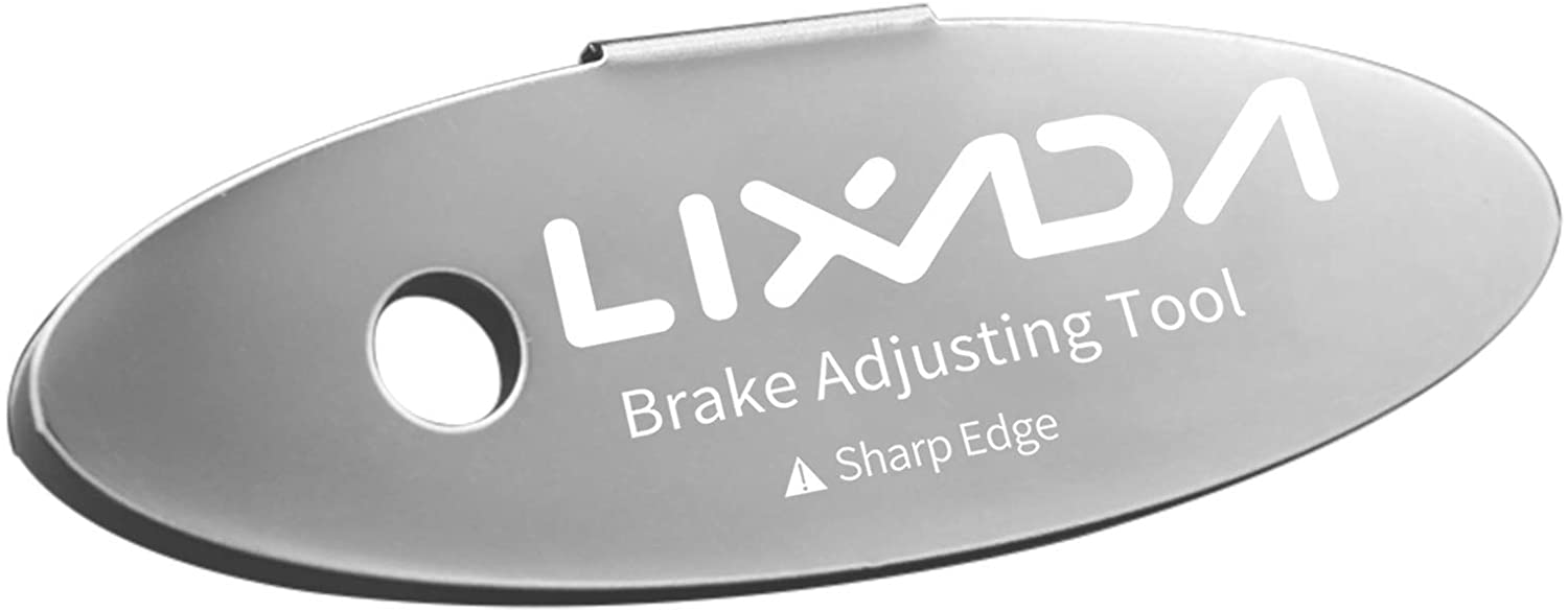

With flat mount brakes and increasingly tight tolerances , getting rotors centred in calipers with no rub can be a pain. Normally it takes me hours and lots of rude words. Sometimes the classic hold the brake and tighten works but often not these days. I used to end up eyeballing it with a light or using the force until I get it just right.
Just got a new bike and had this issue and tried this cheap little tool that shims the rotor either side. Just jam it in, made sure the pads are covered evenly, hold the brake and tighten up. Seems to work first time if I’m careful and then no rub. Thought I would share since others might find it useful.
A tool like that works OK, but is nothing too special. Just a shim on either side between the pads and the rotor. Another option is just use two business cards, one on either side – does pretty much the same thing ( or any spacer the right size). The tool just makes it a bit easier.

I have not had much joy with business cards partly because they can be too thick and maybe they compress?!? Not sure. Since this is metal it is easy to jam in even if some force required ( which was needed with my new brakes which were incredibly tight) and thinner than a card would be. I’d agree any solid shim could be used but this is the right size and holds itself in with the cross piece. If it was $30 I would probably not bother ( and try and fudge something) but for $5 I think it has value.
