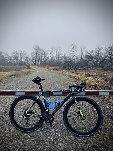

Hey,
I’m hoping someone can provide some insight for me. I’ve googled the heck outta it, and tried many options.
My cross/gravel bike (carbon) has a Thompson Elite post (aluminum) and it’s stuck. Real stuck.
We’ve tried the vice, using the frame, etc and it did t move.
I’m wondering if there’s any other options people recommend. I’m at the point I’m considering cutting the seat off the trying to cut the post from within down the seat tube (if that makes sense)
I like this frame. It’s been good to me for years and seen some things lol
