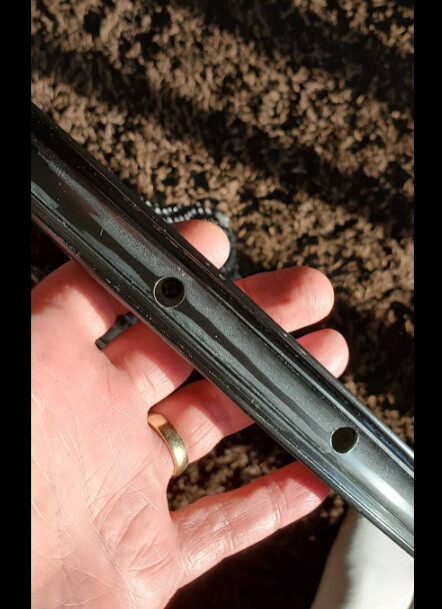

  • this afternoon, I took the tire off and dumped out the sealant and sprayed it and the rim off with the hose. The internal width is indeed 19mm. I got the old rim tape off, but some of the adhesive from the tape is stuck to the rim. I tried goo gone and a rag, and Isopropyl Alcohol 70% to get rid of the adhesive. I also tried a rubber adhesive removing wheel for removing pinstripes and adhesive off body panels to get more of it off. I got the majority of the old adhesive off the rim, how clean does it have to be?
I also took a latex “sander” eraser and removed all the dried sealant that was on the bead of the tire. The bead is looking really good now.

The rim doesn’t have to be super clean. The sealant will help seal small leaks at the tape/rim interface. Just need to make sure the tape is centered on the rim and covering the spoke holes.

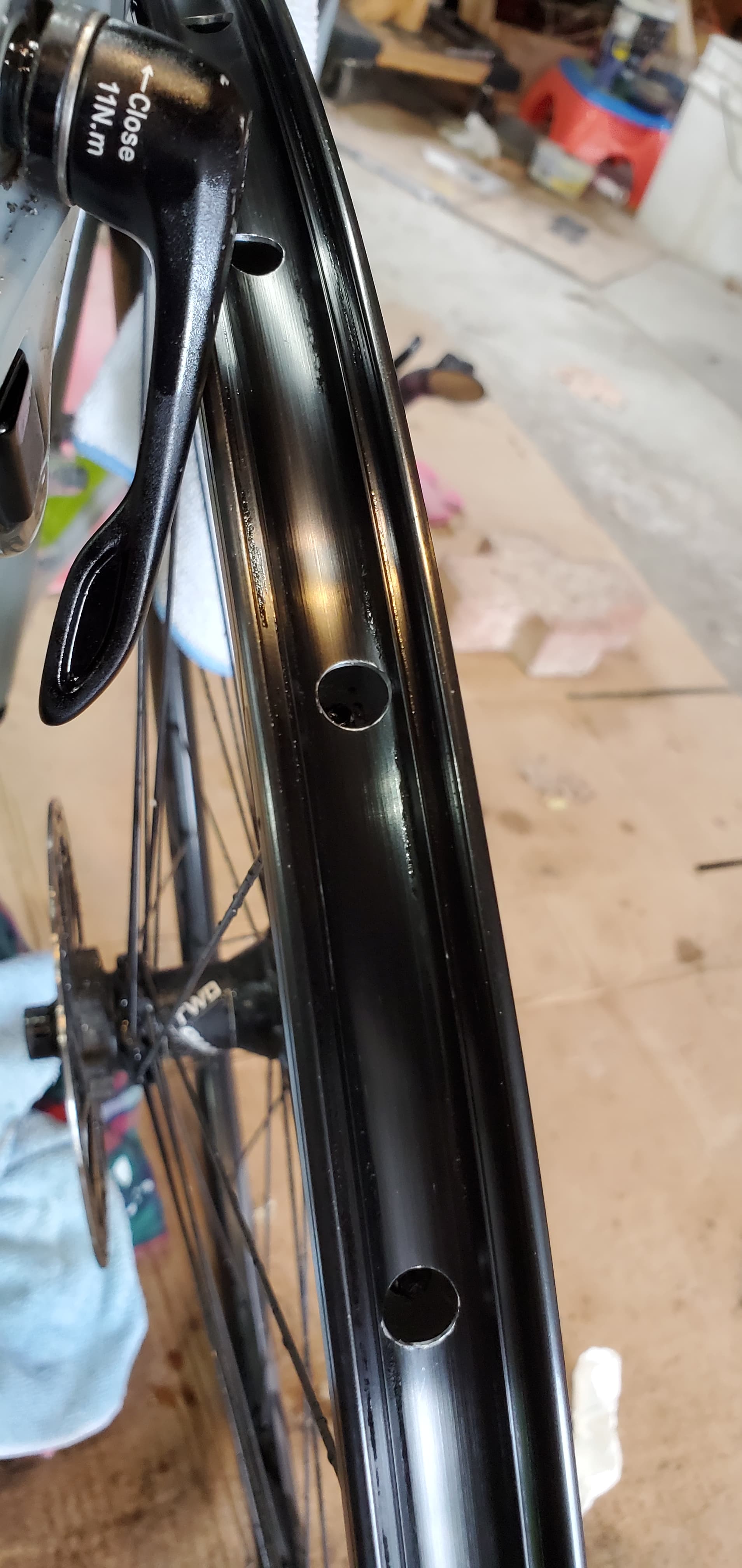

I spent more time with the rim and went at it with goo gone again.
I think the trick is to have the googone sit for about 10 mins to give it time to attack the adhesive.
The rest is just elbow grease.
I went at it 4 more times with googone and its now almost surgically clean.
I washed the goo gone off with soap and water.
Now, waiting on the rim tape. I’ll IPA the rim before applying the tape.
Wow, that’s a clean rim!
Also, that latex “sander” block seems to really do the trick on the tire getting rid of the old dried sealant buildup.

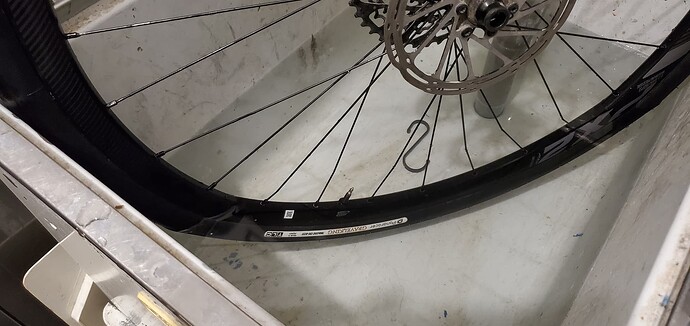

Tire reinstalled. Testing for leaks.
(it went from 60psi down to about 20psi the 1st time I pumped it up with sealant in it)
Now that I threatened to switch to my Goodyear connector tires, it’s decided, that it might hold air.

yeah, the panaracers GK slicks could be on their way to the bin. Rode 50 minutes today and the tire seemed ok… Did the thumb check when I pulled back into the driveway and they were still firm.
Couple hours later, did the thumb check and they were soft again. Pumped them back up and put them in the laundry sink which I hadnt drained yet, and no bubbles. I pumped them up to about 40psi according to my Cdn Tire pump.
