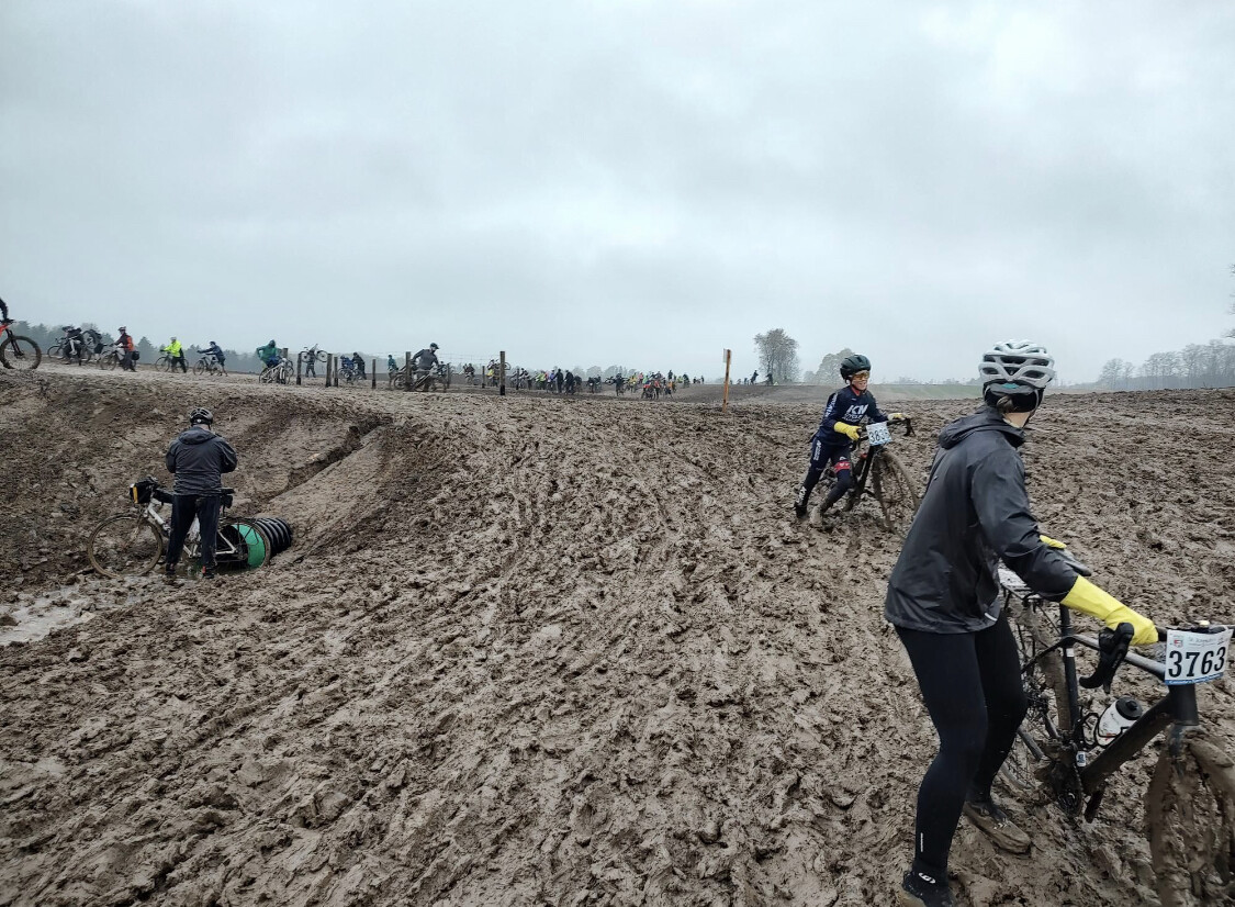

I’m not sure who took/posted this pic from last year’s race…but i believe this was the farm field that destroyed many brake pads (and souls). I remember how quiet it was as we all trudged through there and every once in awhile you would hear a swear word or a groan. I remember wondering if this is what it was like marching through fields of Northern France in 1917.
