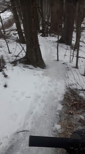

At the Hydrocut March 2019. Super icy, I crashed three or four times on ice before finally turning around and going home. Got studded tires shortly after and they may be expensive, but totally worth it.
