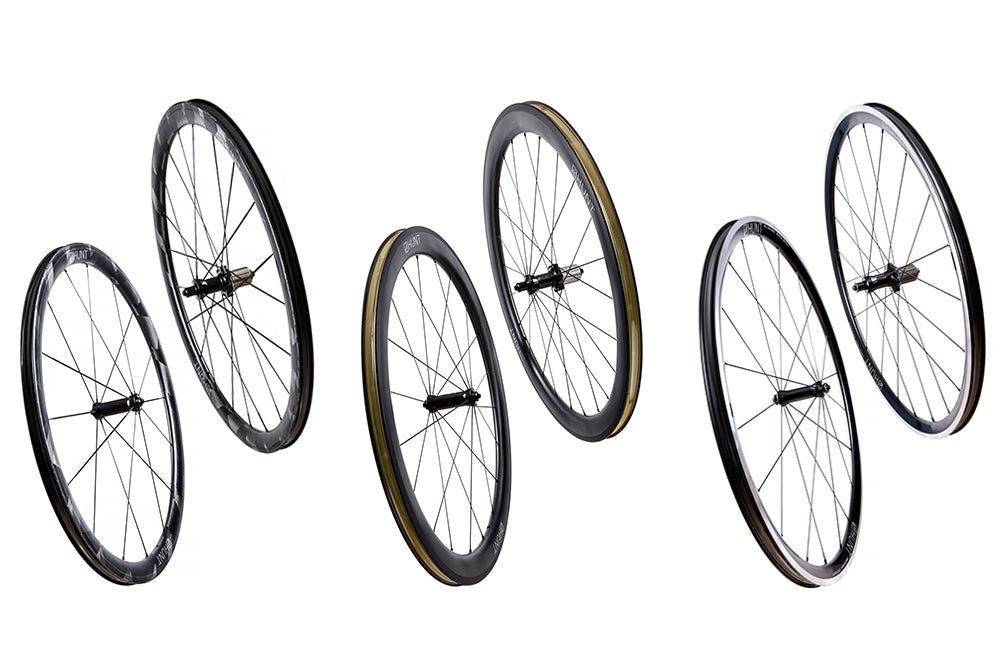

Yes, I purchased a set of Hunt Super Dura Aero wheels last year. They are the best wheels I could find for my size. Like you I am on the heavier side – 110+ kg and in looking for new wheels, I noticed that almost exclusively most wheel builders have a max weight limit of 100kg - including bike and rider. Hunt were the only builder that made wheels built for larger riders. These wheels are laced with 28/32 spokes and rates to 130kg… The hubs I purchased were stock, but they are super smooth and roll very fast. I have been very impressed with these wheels. The most impressive feature, they are nearly bomb proof…I’ve already put 3000+km and they are still perfectly true.
The price was reasonable as well…and the service was second to none. There were delays due to supply chain issues, but they kept me informed constantly…and in the end threw in a free cap, water bottles and the nicest sweat shirt I have.
You can’t go wrong dealing with Hunt… their wheels can be built with upgraded hubs and spokes…and you will never regret it.
