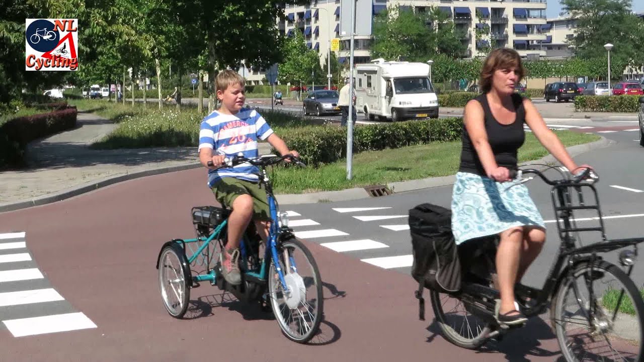

The Roundabouts are a complete failure for bikes though and as more of them are being built they need to figure this out. I have seen some videos how they do it in the Netherlands, but that is very expensive and our governments just will not pay to do things right the first time, so now we have a mess.
I actually sent a video to the city of how the Dutch roundabouts work. Makes ours looks like the death traps that they are.
I totally agree regarding roundabouts. A cyclist has two choices. Go up onto the sidewalk/crosswalk or merge into the right lane with traffic. The city seems to be ambiguous on this. They provide ramps to go onto the sidewalk. However, for an experienced cyclist the best option can be to merge into the lane and take the full lane through the roundabout. The city paints a dotted line prior to the roundabout presumably encouraging us to do this too. Merging has to be done well in advance though and not at the last second. Bottom line is that there is no clear and consistent way a cyclist should approach. This leaves motorists not knowing what to expect and reinforcing their feeling that they own the road.
I really like how the dutch roundabouts have room for a car to be off the circle and wait for bikes/pedestrians.

If I remember correctly, the roundabout at Chancery Lane and Columbia is more like the Dutch roundabouts. If you follow the bike lane it takes you away from the road and there are bear paws for cyclists to legally ride across Chancery. You do lose momentum though. There is also a separate space for pedestrians to cross.

Seriously, I say send our city planners to Denmark where they respect cyclists (for evey car there is 2 million bikes!) and let them take in the beauty that is a Danish roundabout…mmmmm…look at those great bike lanes.
